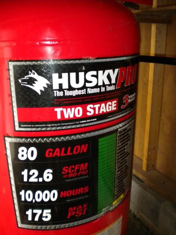

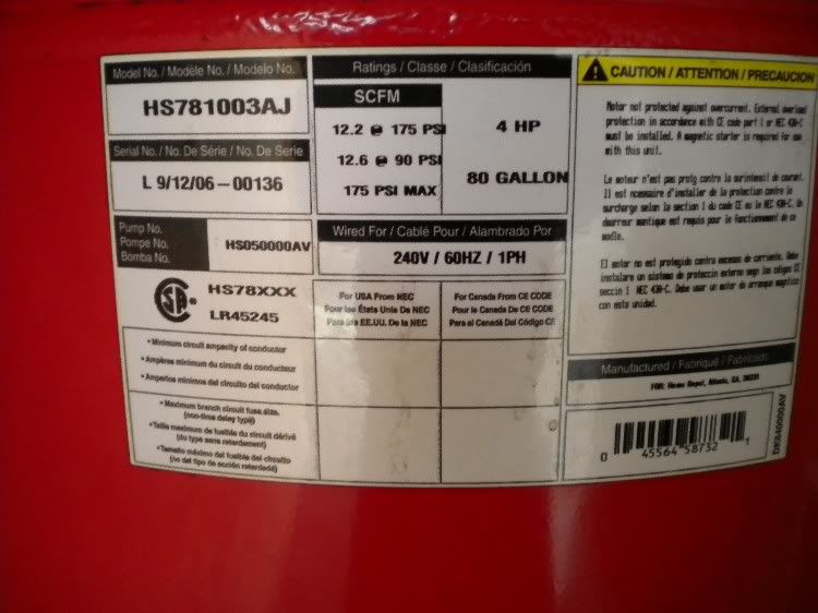

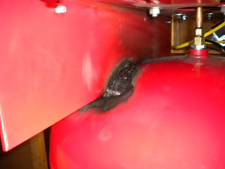

I purchased a used Husky 80 gal. air compressor, it had a date code of 9-12-06. When I walked into my shed where its located the other day, I heard a hissing noise, thought one of my joints need some fresh teflon tape....NOOO, I found a crack by the factory welded on bracket that the pump & motor are mounted on. I shut it down, drained it IMMEDIATELY!
The number on the tank it says to call goes to CHPower (Campbell-Hausfield), so I told them of the problem, they asked for the model#, serial#, which I gave them, they said it was out of warranty, but would check since it was a tank integrity issue. They said YES, they would warranty it, but I had to call a local repairman they used to order the tank & replace it. I called McCoy Auto Parts which was the # they gave me, he says he had to call for authorization.
Mr. McCoy calls me a day later, says that they wouldn't cover it since I'm not the original purchaser. So I call back to CHP to find out WTH is goin on, as I told them that, but since it's not a normal wear & tear issue, they said it would be covered.............nobody will return my calls is 2 days. I need this compressor operationable.........so I called a certified welder, he came over today, had to put some hellatious welds on it, as the crack ran 2 different direction, one of which was followin the FACTORY WELDING.....here are pics FYI:

Ya, you missed the point................these tanks should last for YEARS, way beyond 3 IMO, and as I said, its not a normal wear & tear issue here, its the INTEGRITY of the tank.
I'm curious, what do you think you could do to cause this tank to crack by a factory weld short of throwin it off a loadin dock somewheres????
